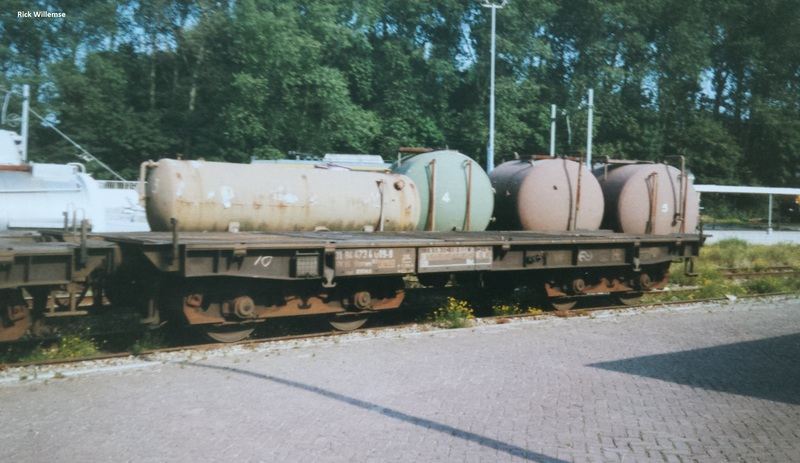

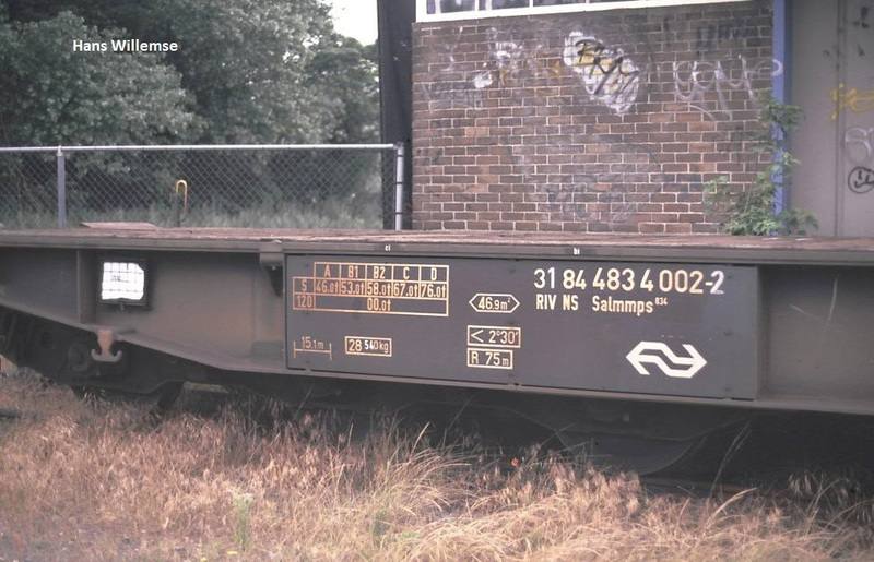

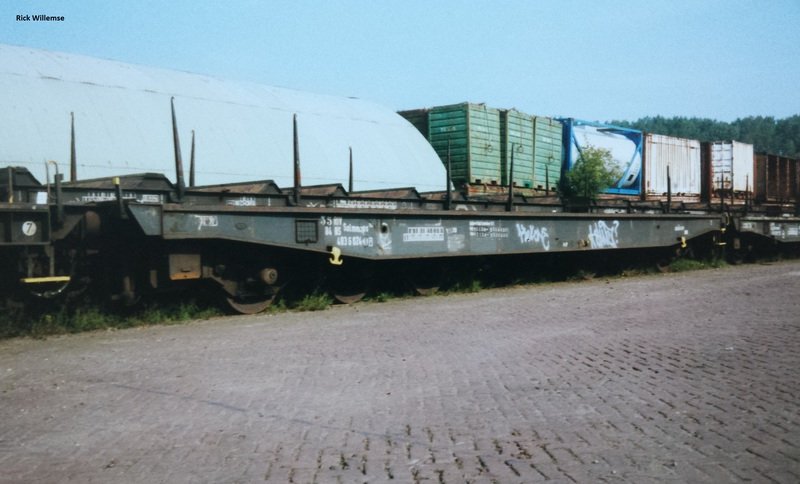

Slmmps
Slmmps
Salmmps
Salmmps
Salmmps detail
Salmmps detail
